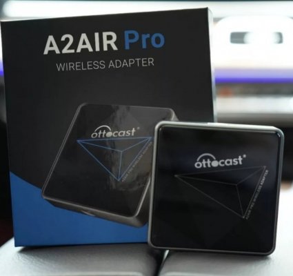

I fixed my similar connection issues S22 ultra 2018 nox, dropping in an out constantly.
Connecting via AA wireless adapter.
No issues no what so ever. And using a phone holder with wireless charging and touch control open and close things couldn't be sweeter. Picture included of the Ottocast I use, but there are lots of devices out there.

Colin, I'm glad you were able to find a work around in the 2018 model. That said, the conversation regarding the issue with AA in the 2025 which already has wireless AA. In that case, the issue is the new radio and GM's need to update that infotainment.
Yeah I thought the newer cars would have the wireless connection standard.
I also thought that connecting via a diffent device and using a USB cable might get around the problem.
Cheaper than new phone too.
