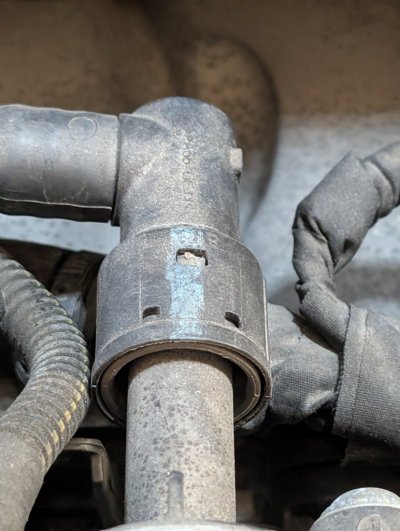

I'm also struggling with this connection any tips on how to disconnect this would be appreciated.
274
128
I think that's one of the wonderful one time use PCV system fittings. Sometimes you can get lucky squeezing them with pliers to release them. It deforms them just enough to release. There's tabs under the collar that lock them in place. There's u toob videos on them.
