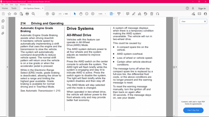

So maybe someone can correct me if I am wrong, but I believe the equinox is always in FWD and you have to manually press the AWD button to turn it on. That’s how my 2019 and my 2022 are at least.

Wrong, unless something wrong with your system; the light on the switch should be lit when active and should retain the last setting. Hopefully, you have your manual; I always scan initially and eventually read the whole thing. This is for 2019 Equinox LT 1.5L AWD
BTW. the manual is downloadable and free for your model year.

Yes I have the manual on my phone. I did not know it would stay on when the car restarted if the vehicle already had it engaged. Shows how much I use AWD Lol
