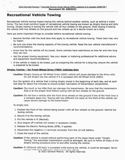

It looks like GM has a solution about to come out. Here’s the document number of a draft owner’s manual update 6003321.
The solution is to disconnect the negative battery cable after all the other steps are completed before flat towing. This is what folks with Chevy Colorado trucks have to do, so it’s not unusual. Be aware that your brake assist may not work anymore as well as your charge line. So some rewiring may be necessary to make this work satisfactorily.

Apparently GM has a draft of the procedure change for the 2023 Equinox and it can be found here: https://www.irv2.com/forums/f85/202...eaf-onramp-offramp-611553-15.html#post6626234
It says to disconnect the battery BUT it also says that the AWD 2023 Equniox can no longer be flat towed.
It's a pretty low-res pic. I had to point my camera at the picture and zoom in with the camera to read it at all.
Those of you with a 2023 AWD Equinox who already towed with the battery disconnected based on a dealer or GM communications had better save your documentation, or create it from memory, or you could have warranty problems in the future.
Let the lawsuits begin. :(

The image is pretty high Rez, but I found that I had to save the picture then view it on my computer. What's in the forum there is a thumbnail. Here it is big.

Haha, very nice! In fact, I just did the exactly same thing and I was about to post it but you beat me to it.
