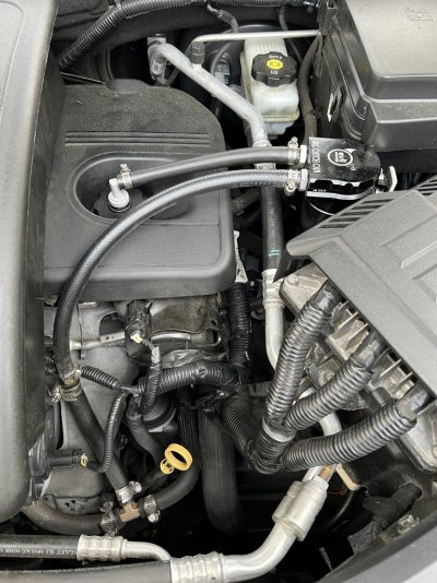

I suspect the PCV orifice in the intake manifold has plugged again. You can continue to take intake off to clean it. Or retrofit with a PCV valve that makes any PCV related problems go away
Tico007
Oct 1, 2023
52
10
Use an oil filler cap modded with a grommet and a PCV valve connected to a catch can connected to the brake booster line. IMG_7081.jpeg
Tico007
Oct 1, 2023
52
10
Unlike the bidirectional orifice hole the PCV valve keeps blowby gas headed towards the intake, not reversing out the fresh air tube. With only fresh air coming in the moisture, clogging and freezing problems in the fresh air tube disappear.
