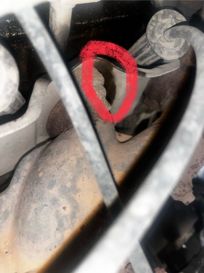

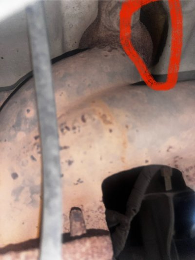

Also I noted a leak of either coolant or transmission fluid on the bottom of the car right below the main drive belt pulley. Don’t know if that has something to do with it.
