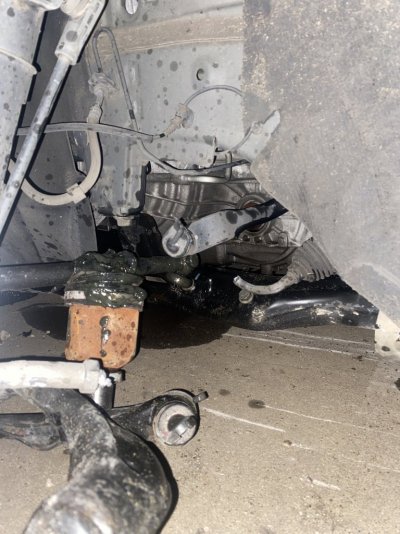

1.5 FWD with P0641 code?!
The P0641 code in a Chevy 2018 Equinox indicates a voltage problem in the 5-volt reference circuit of the engine control module
(ECM) or powertrain control module (PCM):
Any ideas? One minute will start and run good next time will not even start!
Replaced ECM and all Sensors on that 5 volt circuit. Still getting Map Sensor codes.
Replace Whole wiring harness????

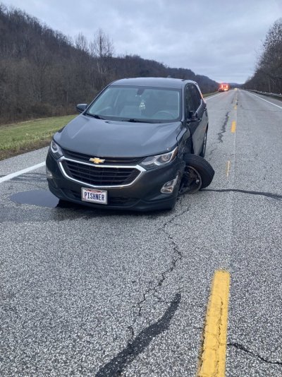

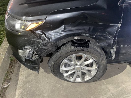

The car was in a wreck, December 2023. Damage to driver side front. Ran perfect for 6 months then started electric problems. I really don’t know if it could be related or not. Bought a new battery last fall.
At a loss here! Ugh!
