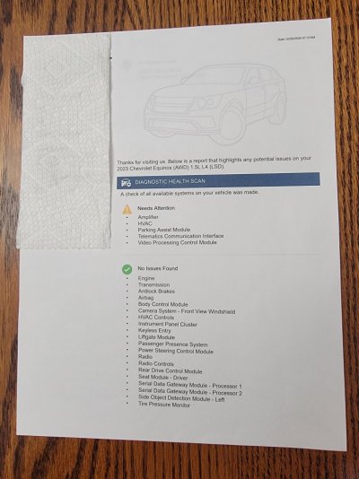

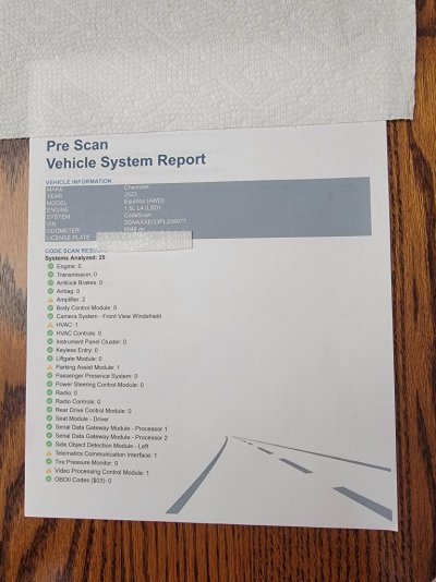

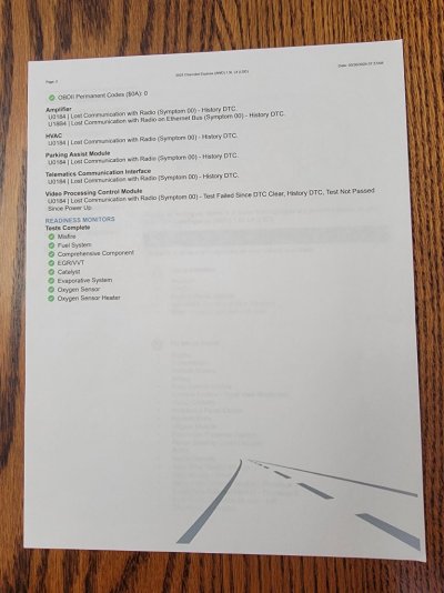

Hey everyone. I have a 2023 Chevrolet Equinox. Did a complete scan of all the modules on my car. There seems to be several U codes or communication codes between several modules on this car. I called the dealer to see if they thought I had a problem that needed to be looked at. The dealer basically said the modules on these newer cars stay awake after the car is shut off and it is normal to have communication codes. Has anyone on this forum come across this who can verify if this is normal or not? This car still has warranty and I would like to get this problem fixed if it truly is an issue. Thank you in advance for any help you can give me.

I know when I shut mine off and am in or near the car for several minutes afterward, I hear all sorts of whirring and clicking things. I never worried about it, and it hasn't seemed to cause any issues, car is 2.5 years old now.

Is there a concern that prompted you to do a full code scan in the first place?
You have to consider there is a million RPO codes that have to be keyed in for GM products so the scanner knows what specific option combinations the vehicle has. Not doing this can show errors.
Any aftermarket electronics at all on the vehicle?

There are a couple of little things with this car that I'm not sure if it is broken or not. In the automatic parking spot mode it seems to parallel park pretty well. When parking in a spot in a parking lot it will not park in a vacant spot unless there is a vehicle on both sides of the vacant spot. I'm not sure if this is normal or not. Also the radio will play music off of your phone. My wife has fob #1 and I have fob #2. When fob #1 is used to start the car the radio should play music off of her phone but for some reason it will play my podcasts from my phone. Here again I'm not sure but I don't think this is correct either. The only reason I did a full scan on this car was because I recently updated my Snap-on modis edge scanner. This scanner reads the vin number of this car so I don't think the rpo codes should be an issue causing the communication codes.
