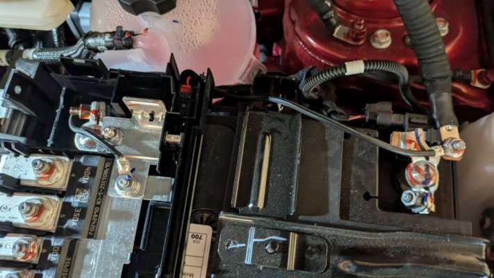

<blockquote data-quote="rawhite318" data-source="post: 24138" data-attributes="member: 8903"><p>Your good. I. Would have put it directly on the positive terminal but that’s splitting hairs. Really the way to screw that up is to fasten it to one of the fuses on the left side of the positive terminal. If one of those fuses blow all 5 of those fuses need to be changed.</p></blockquote><p></p>
[QUOTE="rawhite318, post: 24138, member: 8903"] Your good. I. Would have put it directly on the positive terminal but that’s splitting hairs. Really the way to screw that up is to fasten it to one of the fuses on the left side of the positive terminal. If one of those fuses blow all 5 of those fuses need to be changed. [/QUOTE]
